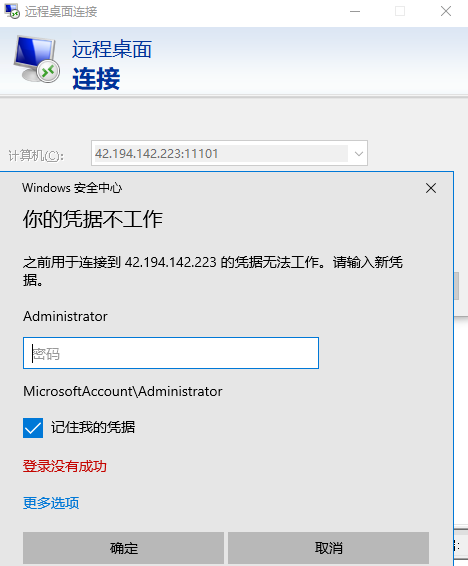

启动
D:\Program_Files\frp_0.47.0_windows_amd64\client>frpc.exe -c frpc.ini
2023/03/29 12:36:26 [I] [service.go:299] [de12e81d53b4342f] login to server success, get run id [de12e81d53b4342f], server udp port [0]
2023/03/29 12:36:26 [I] [proxy_manager.go:142] [de12e81d53b4342f] proxy added: [mstsc http tcp01 ssh]
2023/03/29 12:36:26 [I] [control.go:172] [de12e81d53b4342f] [tcp01] start proxy success
2023/03/29 12:36:26 [I] [control.go:172] [de12e81d53b4342f] [ssh] start proxy success
2023/03/29 12:36:26 [I] [control.go:172] [de12e81d53b4342f] [mstsc] start proxy success
2023/03/29 12:36:26 [I] [control.go:172] [de12e81d53b4342f] [http] start proxy success
测试
ssh,远程连接,http访问,tcp连接
